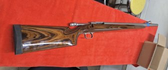

Farley 6PPC
I found this rifle and into it for very little.
Farley action, 6PPC barrel by Bob Green with .272 Neck, McMillan A5 stock bedded.
Barrel looks to be a 14 twist by measuring with cleaning rod.
I have 1000 68gr Bergers and 20lbs of LT32
Berger says 13 twist.
Plan to shoot it at local varmint matches (200 yards)
It also came with a 6 dasher barrel 8 twist
Will I have trouble getting the 68gr Bergers to shoot in the 14 twist?
I ran about 15 through it loaded with 27gr of LT32. 3250 and ok accuracy.
I tried measuring to the lands with a split neck case but had trouble with the 68’s.

Was able to get the measurement I needed for the 68's
1.760" BTO
