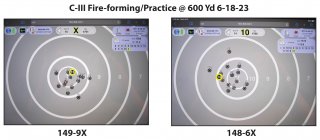

Your setup will work. I've lately been shooting Hornady 75 gr ELDMs out of a practice .223 Rem F-TR rifle with a 26" barrel. They shoot very well indeed:
I have two other .223 Rem F-TR rifles set up specifically to shoot Berger 90 VLDs and Sierra 95 gr Matchkings. For reasons of increased wind deflection, I would not choose to use the rifle fired in the images above with the 75 ELDM load over one of them for a really "important" match. Nonetheless, I think I could do pretty well with it in our monthly club matches. I think if you take what you have and participate in a match or two, you will be hooked. I also think you will enjoy yourself immensely. Give it a try! What have you got to lose?
