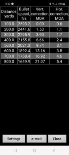

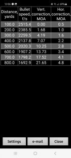

Just for my education I ran some numbers.
223 90 SMK at 2750
308 200.20x at 2650.
Both are mild loads. The 223 is actually inside of the 308.

No, it's not. A .223 shooting 90s inside a 200.20x out of a 30 inch barrel will be screaming hot and will trash the brass in one shot. It's not advisable.
2750 with the 88/90s is what I shoot out of my 26 inch barrel. This is a mild load. And it shoots boringly easily, stays in tune, and barely moves my 18 lbs FTR Elisio chassis.
That's not a mild load at all. 24.5 of Varget gets me 2750 out of a 30" barrel. Either way, you are not shooting inside of a 200.20x with that load.
In my 26 inch 7 twist Wilson barrel and my .230 freebore 223 with 22.5 of AR COMP is 2750. It will go up to 2850, but at 2750 the brass is not getting squished. Lapua Brass.

I think you'll find if you push them much harder than that, it will smoke your brass very quickly. But you're going to need to push those Sierras to about 3200 to match a 200.20x out of a 308. It's just not viable.
