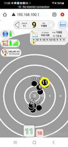

I don't know how the OP did on his 600yd match but mine was PITIFUL.
No wind, temperature was comfortable, but no more shooting with this barrel.
It's been going south for a couple matches and the last practice session I could hold 2MOA.
Counting today's 40 rounds it's close to 3500 rounds.
Replacement barrel finally came in so it retire the old one.
I quit after 2 relays as I did not want to shoot out a sensor.

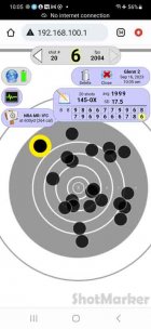

Up three mils was spot on, thanks! I enjoyed myself. Out of three F-Class open shooters, I was in second place; the shooter in first place was way on top of me. Third place was just a few points less than me. 1st and second string wasn't bad, but 3rd string, my dang barrel, was so incredibly HOT that it felt like my rifle was throwing the bullets. Also, I have a Manners PRS-2 stock, a heavy varmint contour. I can't fit a dollar bill between the BBL and Forearm. Should I open up the BBL channel?
