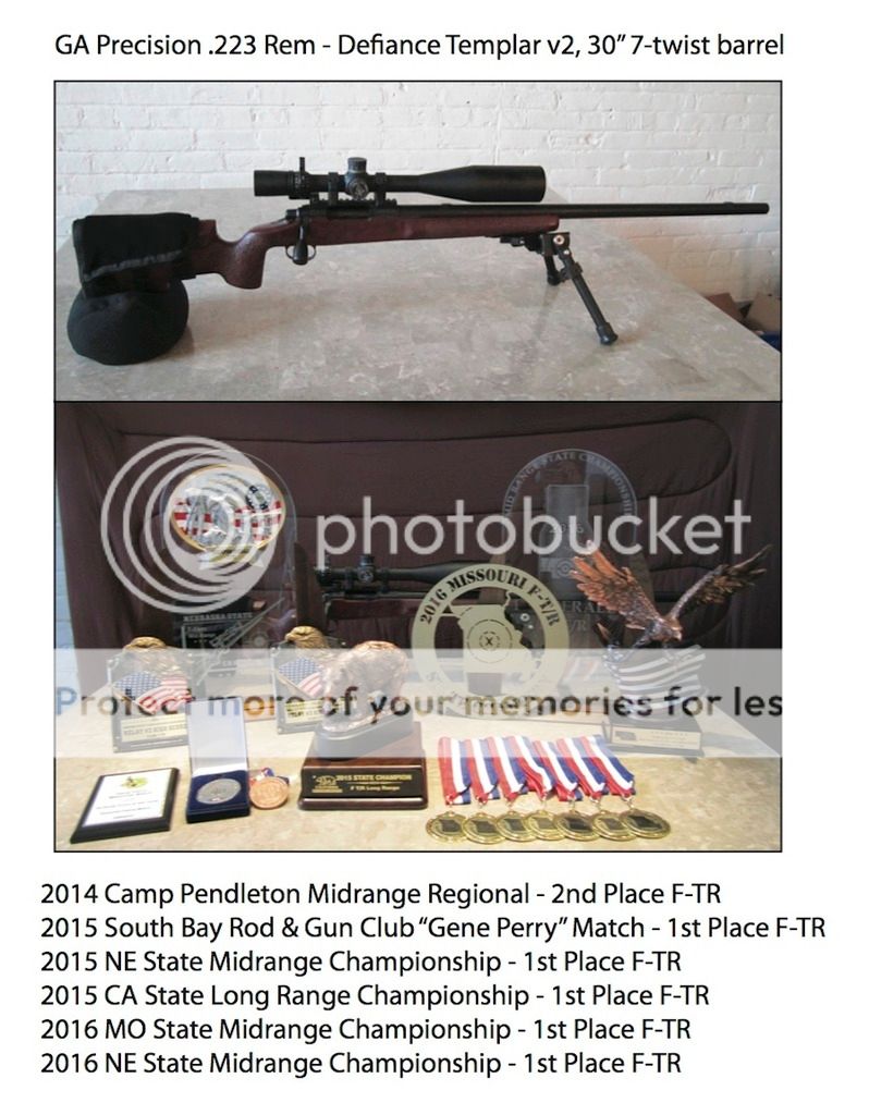

The following were all shot in the last 13 months using a .223/90 VLDs:
Needless to say, I'm pretty pleased with the .223/90 VLD combo.
