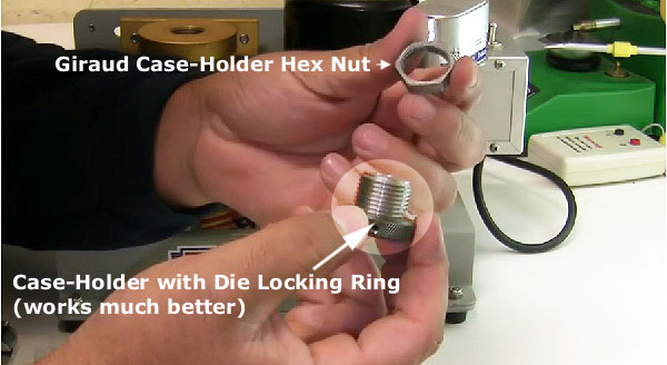

Erik's latest video is featured in today's edition of the Daily Bulletin. Erik provide some very smart tips, including using a die lock ring to set the case holder height (which controls trim length).
If you doubted the precision of this powered trimmer, watch Erik's video. He quickly trims five cases in 15 seconds then measures them with calipers. All five trimmed cartridges measure within .0005. That's an ES of one half thousandth.
Eric also shows how the Giraud trimmer tool can be adapted to trim bullet meplats.
Watch video with supporting photos and text here:
http://bulletin.accurateshooter.com/2015/01/using-the-giraud-power-trimmer-smart-video-from-erik-cortina/
