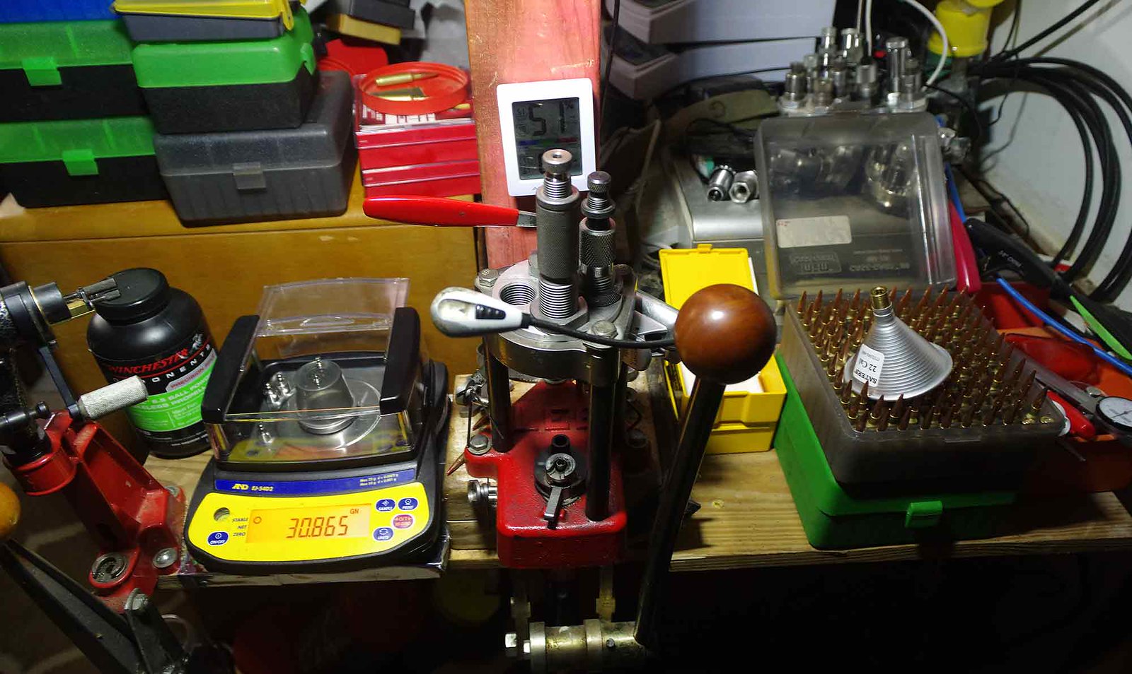

I keep some Check Weights with my A&D EJ54-D2.
1, 1, 5, 10, 10 gram. Bought as ASTM 3, uncertified adjusted using ASTM Class 1 standards. Compared with the EJ54-D2 until I could not tell the difference between the weights.
I can monitor sensitivity pretty well by trickling a couple kernels of powder (currently StaBall 6.5 @ 32.46 grains). I find that calibration does not drift.
I calibrate @ 10 grams on the Low Range, Auto Zero turned OFF in the Menu.
Running off USB power about 4 feet from my modem and see no interference. I monitor Temp and RH only loading when close to 50% RH.
Just finished 98 rounds of 22 Nolser/berber 85.5 loaded LONG.
Saved the last two to make a short video later today for another forum.
Picture of my little reloading corner. Click to go to full size on Flicker.
