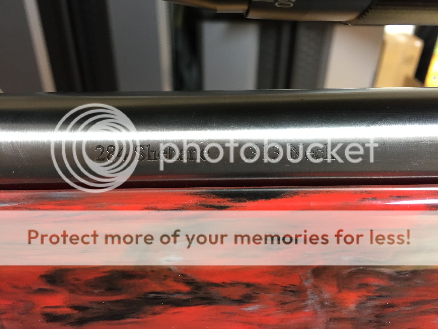

I was using a Carbide 30* single flute cutter with a .020 tip. I switched to a 30* 1/4 round cutter with a .015 tip and the text looks great. I polish the barrel before engraving, engrave, then polish again and the text is very sharp and about .005" deep. Tops and bottoms look good even with the arc of the surface.

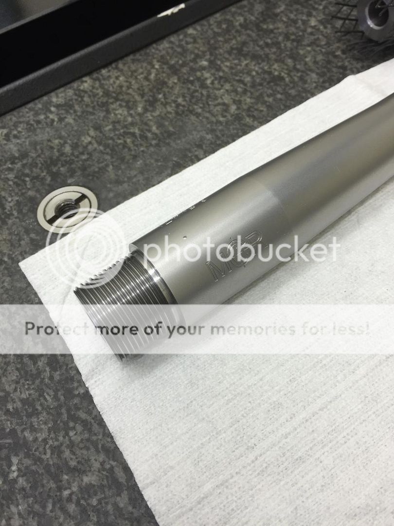

Here's something different and looks great on my barrel.
