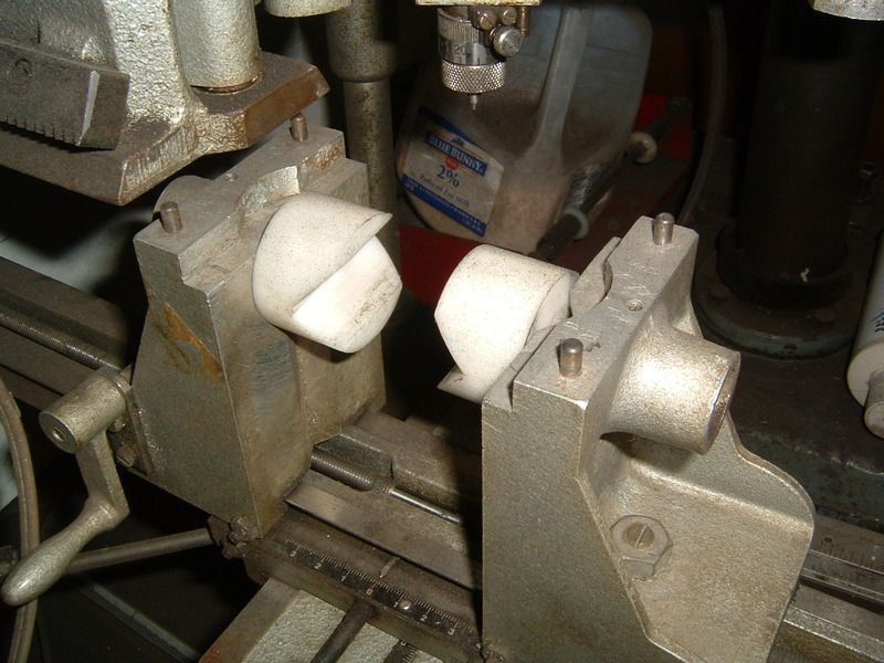

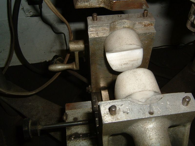

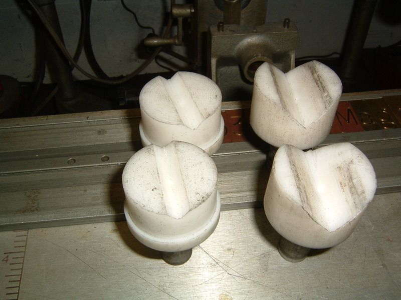

How are you guys holding barrels, I was thinking of making a set of soft jaws for one of the vices that came with it but though I'd ask before reinventing something.
