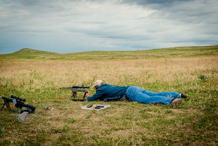

Same barreled action in a rear-grip McRee chassis:
Darrell Holland and I took second place in a LR field/steel shoot (WTRC) this past July. I shot the LR portion of the course (out to and beyond 1K - 10" steel targets) with the LRM.
