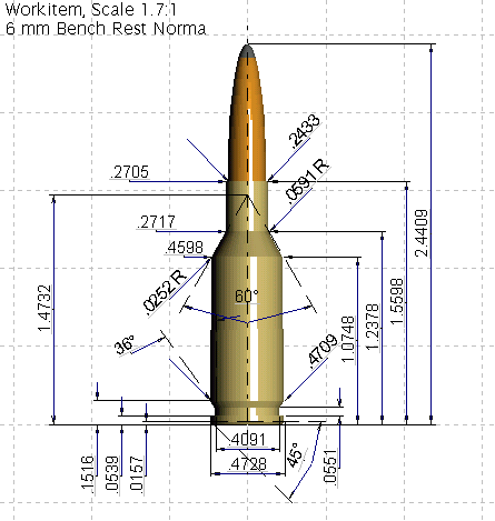

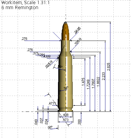

Is the 6BR 6Rem 6norma the same?
I have ordered a new Shilen 6mm SS Match Grade barrel with 1:8 twist today. Will have it installed on a CZ550 action with Kevlar stock. A Leupold 8.5X25 scope will set on top. Will be shooting at Hawks Ridge where I will learn slow or sink quickly.

i always thought a 6rem to be a 6mm rem or a 244 rem. not sure on the 6norma? BTW a wise man can learn from a fool, a fool can learn from no one. so if you don't ask questions, how can you learn. good luck cliffe
Not sure what you mean by "6Rem". That's too vague. 6BR is completely different from "6mm Remington"
6BR also known as 6mmBR Norma,and sometimes called 6 Rem BR, but that is pretty much out of date because the cartridges was changed and standardized by Norma):
6mm Remington:
