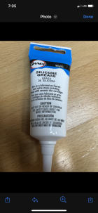

Get some this and will help a lot with being able to turn it.

I will say that on the two barrels I have set up for them they are super tight... like I may have to find a pair of soft-jaw pliers to be able to turn them. Might have to try that silicone grease mentioned above.

Mine was super tight as well and I reached out to Dan to see if another o-ring size was the fix and he turned me on to the Danco silicone grease designed to work with stainless steel faucets and rubber o-rings. Problem solved. Works like a champ.
