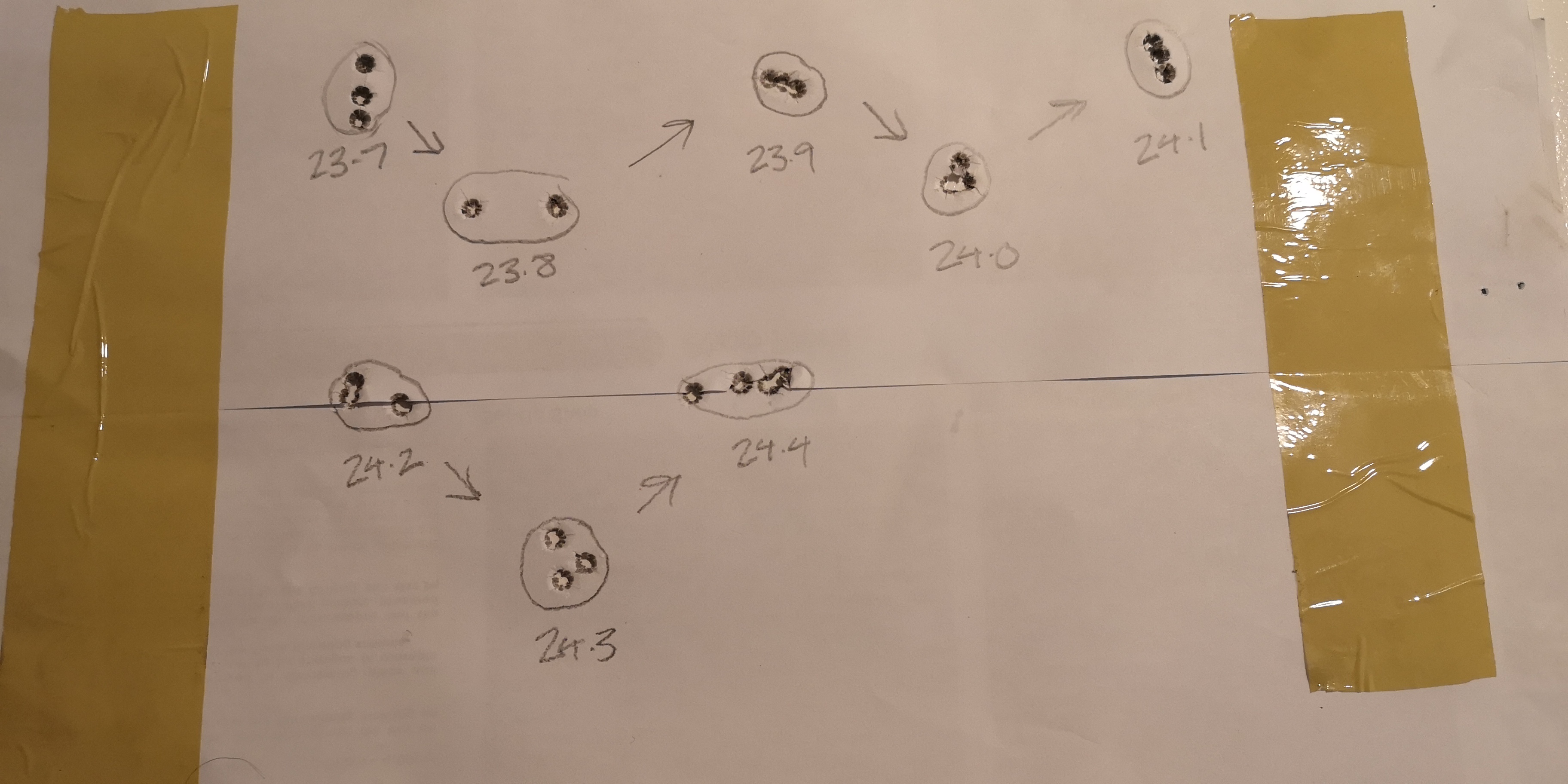

These are the results from the last 8 groups I shot at 200 yards. I have not played with seating depth and loaded these at "jam minus 20" using Eric Cortina's method. In reality, this load is still lightly jammed.
While they are only 3 shot groups, they are also at 0.1gr intervals, so I consider them to have some statistical validity.
At this point I think I will load up at 24.0 and not bother playing with seating. 23.9-24.1 were all under 0.35" at 200 yards. Velocity at 24.0gr was 2820fps, average.
I'd caution anyone against replicating these charges as I have a ton of freebore and my lot of H4895 is somewhat slower than others I have used in the past.
Suffice to say, at this stage I am very pleased with the 88gr ELDM's in the 32" 7 twist 219/224 barrel. If they continue to hold together, my original idea of elds for local matches and A tips for when I travel should work out.
