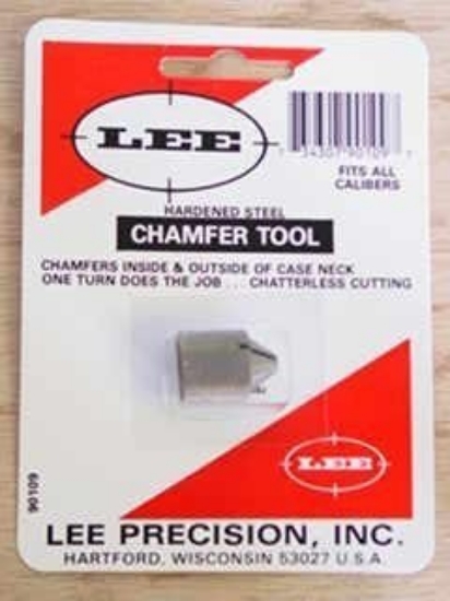

Why not use the length mandrels and case holders you already have and get the Lee cutter and lock stud ?
Mount a drill horizontal in your vise and fit the case holder and lock stud to it.
With a trim that removes the neck chamfer a touch inside and out with the Lee chamfer tool replaces it.

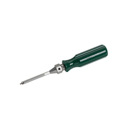

While you have the case spinning a once only hit with a flash hole deburrer and all your physical case prep is done at one station.
