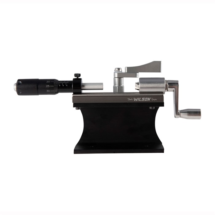

If you want to go manual and accuracy from from case base to mouth, then an LE Wilson case trimmer would be the best way to go. IMHO

If I liked machine guns,…. I don’t!… I would want one of those fancy electric do all jobs but for benchrest and hunting I never had to look past a Wilson,…. Can keep them with in.0005 of one another and that’s good enough for me.

As far as precision goes there are some that may match my Wilson but none that will do better.

If you are shooting flat based bullets then get the VLD K&M inside neck chamfer and the Wilson bullet deburr/chamfer. If you dont do flat base then just buy the Wilson.
However, any that do not use a pilot would be adequate for me but it's hard to imagine anything better that a Wilson with the Sinclair upgrades. You will have to chamfer the inside and outside of the neck after trimming.

I still have the Wilson and the Henderson. The Wilson looks good, but is just gathering dust while the Henderson is a workhorse.
