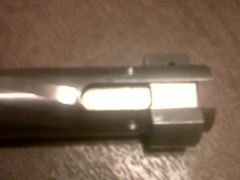

Here is a bolt with cut (cut made by kiff) is there any dimensions I could measure for you?
I too have ordered a mini m16 extractor kit from PTG. The e-mail reply for demensions was the extractor is .187 wide. That is all they sent. I replied that I could measure that myself. I wanted to know the depth of cuts and pin hole size and location. Reply back was they have a nda (non-disclosure agreement?) with Remington and they could not give me that information. So, I ordered two bolts with the cut outs for the mini m-16 extractors and made a blueprint myself.
