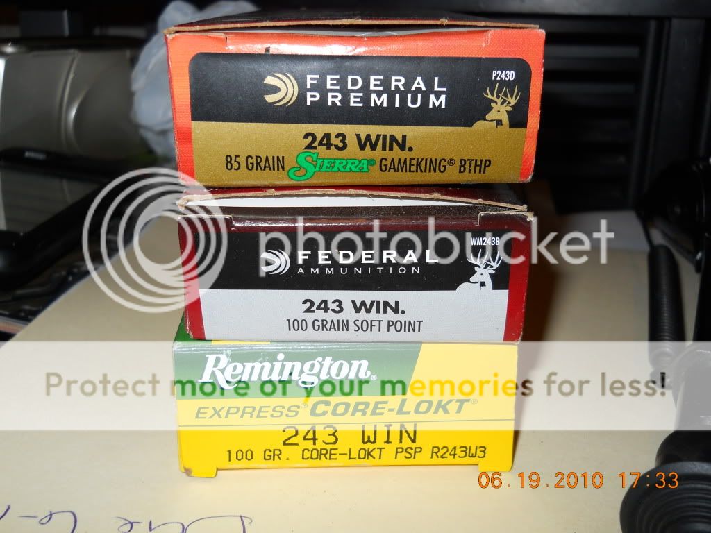

Well I got to go out and shoot it today. I tried three different types of bullets. The bullets I used are;
Remington Express Core-Lokt 100 grain $17.99 a box
Federal Premium 85 grain Sierra Gameking BTHP $30.00 a box
Federal Red Box 100 grain Soft Point $13.00 a box
I used these because they were cheap and because the place I got them didnt have much of a selection.
The Remington 100 grain and the Federal 100 grain both shot pretty good and was spacing about .5 to .75 moa.
There was NO problems with feeding and the gun and bullets performed great together.

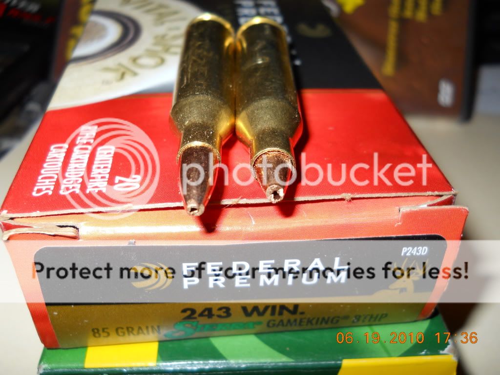

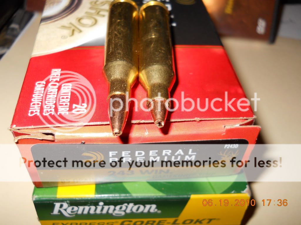

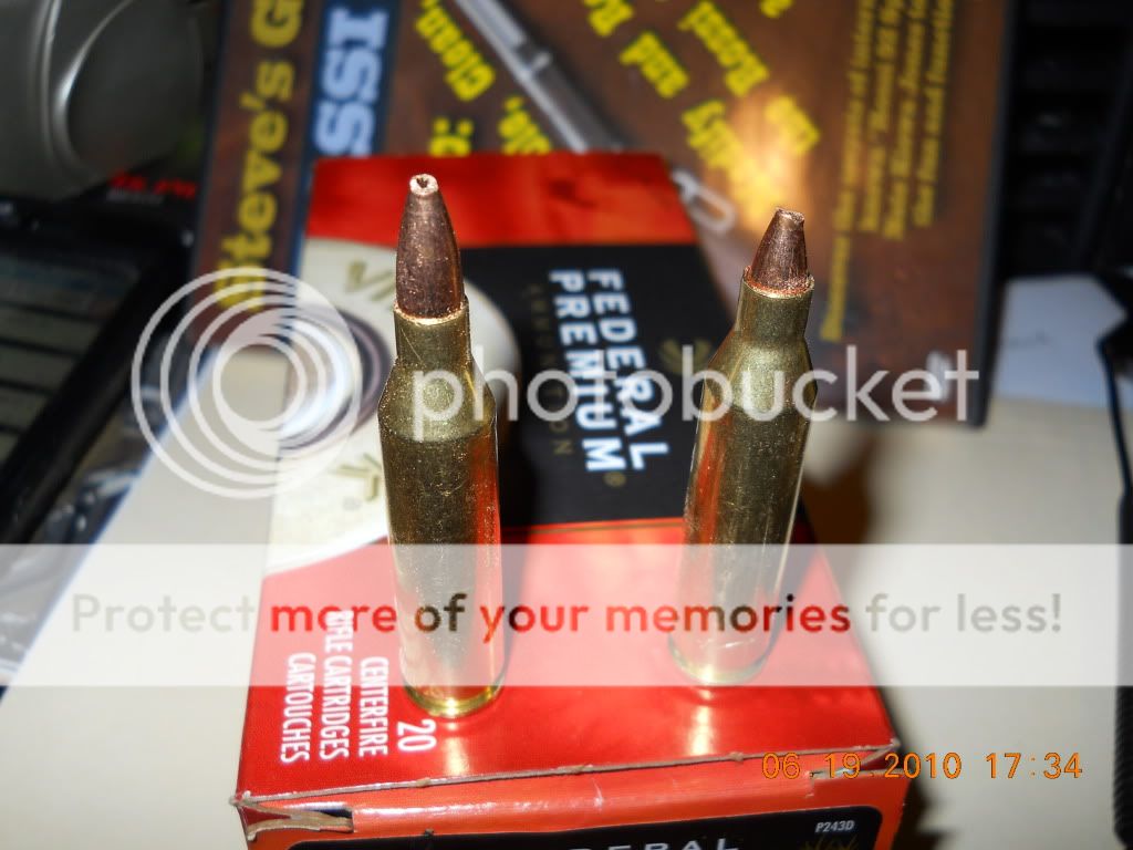

Then I tried the Federal Premium 85 grain Gameking BTHP. The gun racked the first round out of the magazine and shot right at point of aim. Then the gun would not pick up another round off the magazine. Every time I would clear it and try to rack another one it would hit the feed ramp and never go into the barrel. It was marring up the bullets and in one case it even pushed the bullet back into the casing. I think this was due to the nose of the bullet being somewhat squared compared to the other and the hollow point being possibly softer letting it deform the nose of the bullet.
When I loaded them one by one they shot great. The groups were consistently smaller and stayed around the .5 mark.

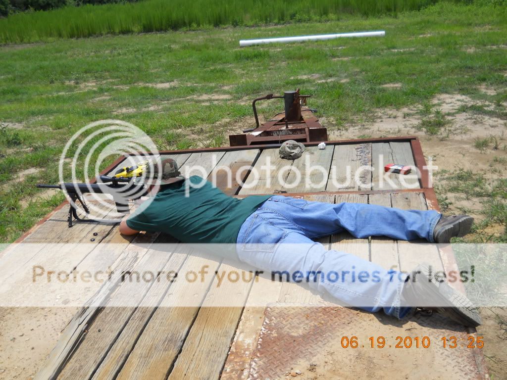

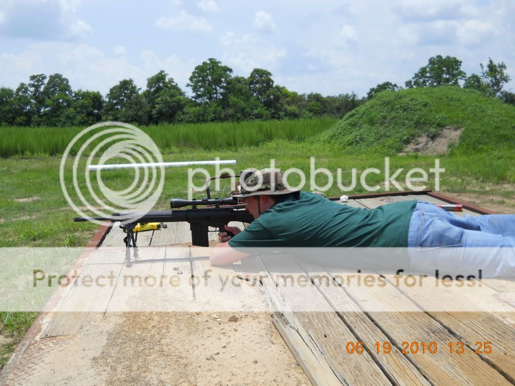

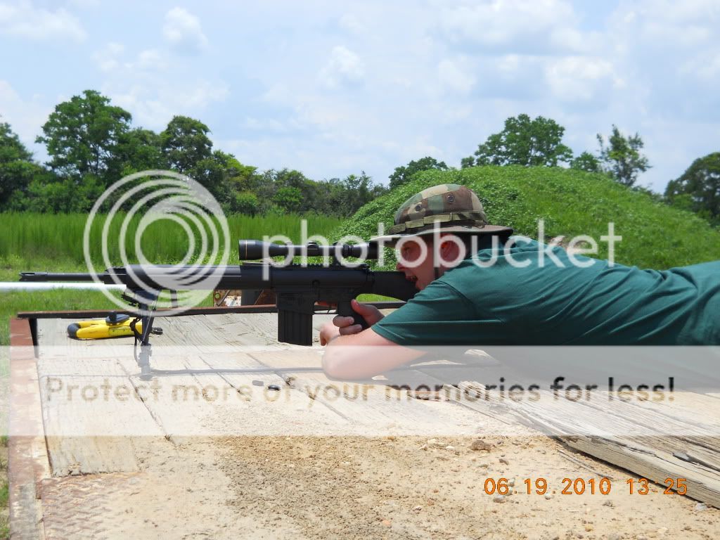

It was a miserable day to shoot where I was shooting. No shade whatsoever and the temp over 100 degrees with about 85% humidity and I was laying on a flatbed trailer and felt like a piece of bacon on a frying pan.
My left leg on my bipod worked itself loose and that made it kick further out causing the gun to lean. Then with no warning the clouds moved in and the bottom fell out of the sky. Thunderstorms moved in and that was the end of my day.

I have read a lot about this rifle and intend on purchasing one new from rguns.com for $935 in a day or two. Everyone has said to chuck the stock mag and get Magpul mags, and that will alleviate your problems because the Magpul mag holds the round at the proper angle for feeding. Hope this helps.
nice rig. If you do reload and are going after varmints, you might start with the 70gr Nosler or Sierra Blitzking. Those bullets shoot in every 243 (granted that it is only a sample size of 6 or 7) that I've tried.
I will second chucking the stock mag and getting some Magpul mags. I had nothing but issues with my DPMS LR308 feeding properly until I got some better mags, and Magpul's worked well for me.

nfhjr62, that is a flatbed trailer, but not a fifth wheel. You can see the hitch in one of the pics, and it's not a goose neck for a fifth wheel hitch.
