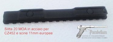

Try this one:
http://www.parabellumarmi.com/prodotti/Contessa_A_-_Slitta_in_acciaio_per_carabina_CZ452-455_inclinata_20_MOA/MOAS201309200919260000002626.html

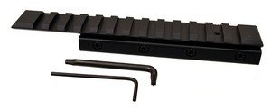

Champions choice has this version:
Sun Optics 9.5mm-13mm Adjustable Base To Picatinny Top Part # SM7015
SUN OPTICS 9.5mm-13mm ADJ BASE TO PICATINNY TOP SM7015
Retail Price $24.00
Quantity
In Stock: 5
I have a NF Competiton mounted on my 1913 Anschutz with this one.
Could use Zee rings with adjustable inserts to get your 20-30 degree requirement.
