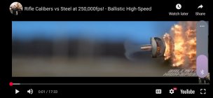

Everyone talking about soot on the case neck as an indicator of the neck not sealing before the gasses leaving the case, need to consider why recovered bullets have no similar carbon ahead of the bore diameter of the bullet. If gas gets out before the bullet seals the bore, they will be ahead of the bullet. Video seemingly defies evidence held in your hand.

View attachment 1647705I've watched many ultra high speed videos where gas is coming out of the barrel before the bullet.
Me too. And from what I've observed it seems the further back from the lands, before the bullet is fully engraved, the greater the amount of gas comes out ahead of the bullet (e.g. Blow-by). The minimum amount is when the bullet is seated where jammed into the lands, which does makes a lot of sense to me.
the interesting thing in the video is the cloud of gas leaving the barrel ahead of the bullet, and seemingly surrounding the bullet for about 4 inches out.
