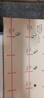

Here's what I believe is a good example of seating depth making a difference started at 4 in and went to 10 in the group shrunk each group when going further in. Until it hit the best seating depth

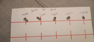

Here's another example I just did recently before a match on some new bullets in a 30br. The 1.674 seating depth was good to go. The match yesterday I used it in I was able to shoot a 250 and 22xs.This I started at max jam and worked in the case. (Still in the lands). I believe seating depth most certainly matters.
You should have a separate target for each shot group. Shot 4,5&6 on the shoot and see target are the best group but it doesn’t match what you wrote down. If 4,5&6 are labeled correctly as far as the holes in the paper, that’s a good group. For me, I can’t have that much chaos and attempt to draw a hold on target for data collection. I don’t know how you kept up with the holes.
I labelled 2 consecutive groups
So shot 1-6 and 4-9
The smallest vertical was 16 to 18
