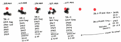

Update:
Shocked at how well long jumping works. Totally shocked actually. Velocity dropped 77 ft/s, but stayed pretty well in tune.
I don't call that staying in tune. I see distinct group shapes that I look for to occur and repeat, but at much smaller increments is all. I would take that middle group, the .230 with mostly vertical and move .003 at a time on both sides of it, for at least 4 three shot groups on both sides of that. You'll see a progression of group shapes that are predictable and that repeat. That info can be used to tune on the fly. I'd bet .003 one way or the other of that group shoots smaller and with less vertical, just based on what I'm seeing in the pics.

Id say that's about right. However, GRT models showed pressures increasing as bullet is seated into the case more which did not prove true in my testing. Velocity only dropped and stayed dropped, actually normalized, from .055-.105 away from the touch point.
That's not going to work for me. This is a field match rifle, matches could be a few hundred rounds at a time, so the strategy I wanted to test was to park the seating depth and find something that will be good for the life of the barrel. Im sure there are ups and downs along the way, but I tested three distinct spots (start, middle, and end of total erosion) to get a big picture view of what's going on. I found something that will work for this. Prior to this effort, I would constantly chase, which worked well too, but I had to stay on top of it. Running out of neck is a new problem to me.

Update #2 for those interested. Followed up with bit more powder to get up over 3,000 ft/s to see what would happen. Still a bit surprised things hold together so well jumping this much. For this testing in general, I would say that jumping a long way, at least with Berger hybrids, is no more or less precise than where I'd usually jam to. Really, this rifle is probably not capable of resolving differences. It clearly ebs and flows like you'd expect. Jumping a long way maybe dampens velocity variation a bit. But it did get me out of this bind of running out of neck to grip with, which is a win I suppose. Preciate everybody's input.
