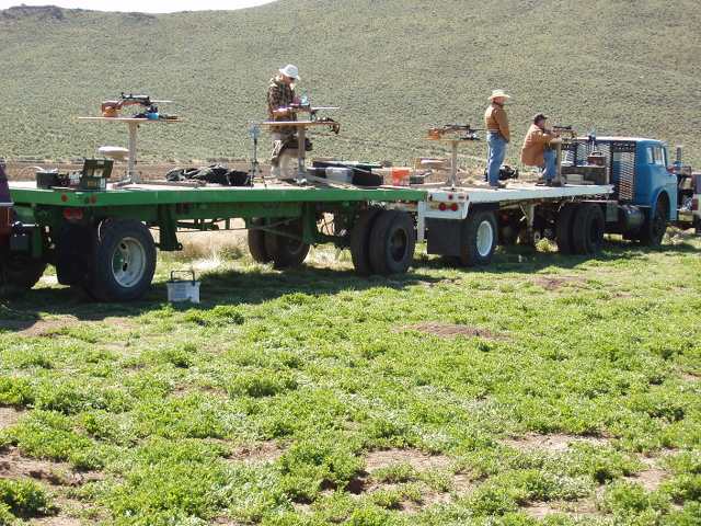

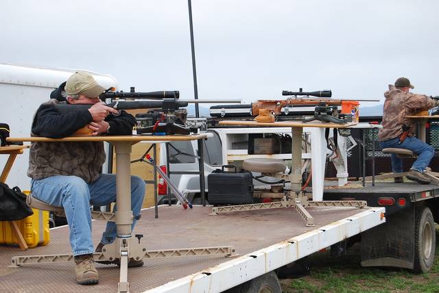

Since I started shooting both PD's and squirrels seriously in 1968, the evolution has morphed into what we deem ideal (to us, maybe not for all). The end result is a BR Pivot or similar rotating bench up off the ground in the back of a pickup, or better yet, from the elevated bed of the ranchers semi hay trailer, ranch flatbed, or from a rise in the elevation if possible.
Moral: Elevation is THE key.

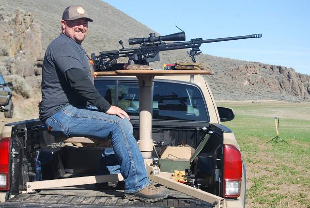

We cover the pick-up bed with a platform and use pivot benches similar to the BR pivot. The benches are anchored so we can move to a different site without doing a total take down. Everything stores underneath, clean and dry. We may travel with a cooler or two and a 5' ladder for access on top. We also have an aluminum 'cross box' tool box for our rifles and everything else. We have good elevation for the rifles, about 8' and are able to shoot 360 degrees. There is room for 2 benches and a tool box on a standard 8' bed pickup, one shooter and one spotting. Camper braces will steady the truck very nicely. We've been using these quite a few years now. I saw a fiber glass step ladder and bag used for support, it seemed to work pretty well on Nevada sage rats.
