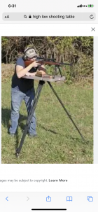

Check out the MTM High-Low Shooting Table. Its on a 3 legged stand, you can adjust it so you can shoot standing up if want or sitting, very stable and not overly expensive at around $120. Highly recommend it, and you can get very steady on it.

Exactly, one of my buds stands about 6'3" so he will sometimes shoot standing up, I like to sit on a stool, I can swivel the table quite a bit, easy to do adjustments up and down and you get that table set, its rock steady.
