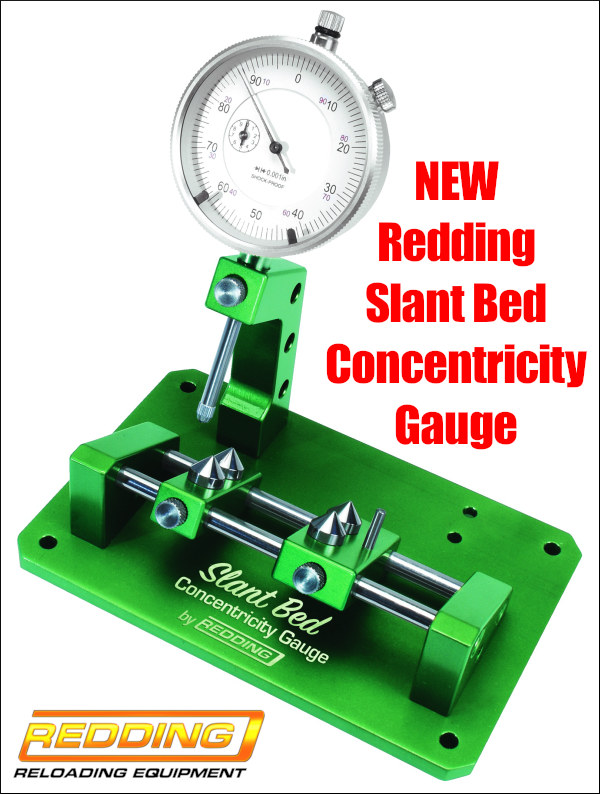

Below Redding has a new concentricity gauge that looks interesting and better than the ones I have now.
Redding Offers New Slant-Bed Concentricity Checker
http://bulletin.accurateshooter.com/2020/02/redding-offers-new-slant-bed-concentricity-checker/
The first thing I notice about the Redding is the gauge is at the opposite end and your case would point the other direction I like that being left-handed mine work fine but are slightly uncomfortable I think I would like the Redding better I have they RCBS case master now
If you look at the holes in the Redding base of the new gauge, the gauge can be moved to either end of the base. Meaning for left or right handed reloaders.
