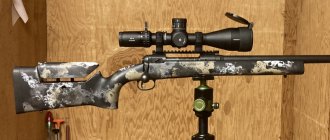

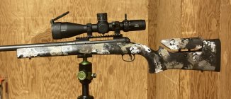

I looked back about 12 to 15 pages and I couldn’t find anything so I figured I would start this thread so that we can share information on how we may modify or paint our stocks. I’ve gone the cerakote route which is great but I find myself always changing things enough that I can take a rattle can and paint a stock in less than an hour. I would love to see some of you guys work along with maybe a couple short tips on how you did the application.
I’ll start with this picture. I’m absolutely in love with my almost 6 year old. She helps me in my gun room a few times a week. I finally turned her loose to paint her own stock. She picked out all the colors. She held the back of the can while I sprayed the basecoat of the light green color. I sprayed each color as she asked for it on cardboard and let her blot it with a sponge and then onto the stock. She picked out what color and where it went. She actually used bubble wrap to apply the white dots. I taped the bubble wrap around a small block of wood to make it easier for her to grip. Honestly it turned out better than a few that I have done. She was awfully proud of it717CEBA9-50F8-4C0A-9BA5-F6B1A7DA134D.jpeg7A303A10-D252-4060-A4EB-6FB878386B3F.jpeg5DE2686F-9E65-43FD-A307-EFEDD3FCC843.jpeg

Here’s another one I did a few years ago in a gap style camo. I cut out my own patterns by overlapping blue tape on an old cutting board, drawing the shapes I wanted with a sharpie, and then cutting them out with a razor knife. I painted the whole stock black, then laid the home made stencils where I wanted them, then sprayed the whole stock khaki, and laid down more stencils, then I sprayed the whole stock OD green, and then removed the stencils.C2730824-FCE7-40E5-B96E-FEDE9D20E788.jpeg9A540007-FB60-400B-87D5-F6D2A5EF83AE.jpeg

Here’s another one I did a few years ago in a gap style camo. I cut out my own patterns by overlapping blue tape on an old cutting board, drawing the shapes I wanted with a sharpie, and then cutting them out with a razor knife. I painted the whole stock black, then laid the home made stencils where I wanted them, then sprayed the whole stock khaki, and laid down more stencils, then I sprayed the whole stock OD green, and then removed the stencils.View attachment 1361363View attachment 1361364
Very good job!!
