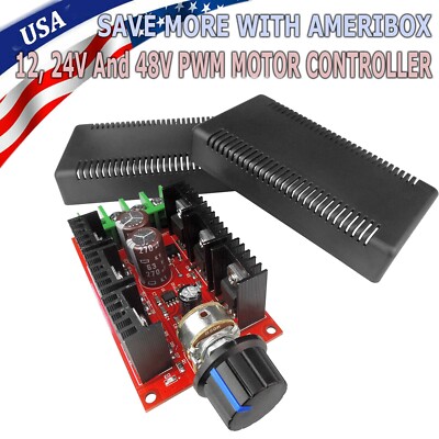

It’s a simple circuit that switches a load on&off at a given rate, having an adjustable duty cycle to effectively adjust the average current through the wire. Here’ a link to one similar to the one I used:

Did you go for a Jfet or Mosfet on your controller?

I'm an audio guy, I like Jfets, lol! Mosfets are a bit easier to plug into circuits than Jfets, but Jfets are more stable. Though I suppose a PWM controller for a hot wire doesn't really matter in the grand scheme of things, lol!

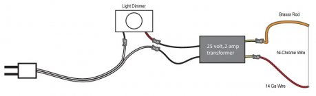

Don't over do it. A rotary dimmer light switch (push on-off) and a down converter is all you need. Plus some nichrome wire. Build a table (bigger is better so the foam sheets can slide easily) and arm like Buffalobill and you're done. There's a bit of technique involved in the actual cutting to avoid flex of the wire by the foam but that's about it. I highly recommend making a stencil (as Buffalobill did) in stiff cardboard for each part (rather than marking the foam directly). Pin these in place and use the stencil as a guide for the hot wire.Image.jpg
