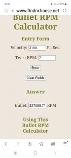

Very interesting.
3180 is above terminal RPM with a 7 twist.
3180 is close to ideal rpm with an 8 twist.
Just doing some numbers.
