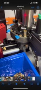

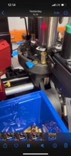

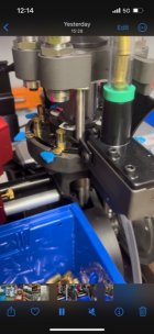

Is anyone using a Dillon rl1100 with auto drive from mark 7 ? I am having nothing but problems with it . Attached is some issues I am having . I know it’s blurry but sometimes the round gets stuck at the eject finger or it shoots out .

Adjust the angle of the case ejector.
Lower it to within a hair of the shell plate.
If it still gives you fits, slightly bend the tip of the ejector closer to the case so it starts moving the case sooner.
How fast are you running your machine? I have found a sweet spot around 2,000 cases per hour and a 1 delay at the top for 223 and no delay for handgun calibers.

I am only running 1,000 per hr . I don’t have a delay for pistols . I feel I can’t get past 1,000 hr to work my way higher .
That bolt holding the tab on also looks loose maybe at a minimum the tab is bent? Either way, like hoser said, the tab needs bent back and adjusted. You could also order a new tab and match the angle and then have a spare.
Take a picture from the top down if you can and post it.

When I first bought the press it was set up for 223 , everything ran perfect when I did it manually. Once I got the auto drive and switch to 9mm I started having problems . It’s probably something I did that’s out of tune . I am gonna try what everyone said first before I call Dillion. And yes the mec 9000 does suck to set but I have one as well
Here is how mine is bent/setup if this helps give a starting point. Make sure it's flat along the press interface, and the tab is bent forward and doesn't hit the locating pin. Pardon the filth, I'm behind on processing. Haha.
I think mine could use some bending , thank you for the pic
