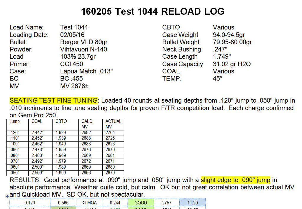

When I make a batch of ammo, I start by producing a load log using M.S. Word. Each load has a serial number as well as a date. My .223 F/TR rifle uses logs starting with the number 1000; my 6mm BR load logs start with 600, and so on. This preliminary load-log serves as a guide during the loading process.
I use the previous log as a template and change the serial number, date, etc. I do not have to re-type all the information, only the new or different data, much of which is in the form of a table. I also write a short paragraph about why I am making a particular batch and mention any other factor(s) which might be important.
I copy part of the load-log data table and transfer it to a Photoshop file so I can quickly print ammo box labels. Again, this is a simple process once you have the first template made. I attach these labels to conventional plastic ammo boxes using clear packing tape.
At the range, I keep only the barest of hand written notes sufficient to keep me from confusing the data I'm recording. After I test the ammo, I go home where I scan and record every target group using On Target scoring software. I also extract muzzle velocity and standard deviation from the smart phone I use in conjunction with my chronograph. I transfer the scoring data from On Target into a M.S. Excel worksheet and add the chronograph data by hand along with a little bit of additional information like powder type and bullet weight.
Then I open the M.S. Word load-log again and I copy/paste important data from the On Target scoring software or from the Excel Worksheet. I often include a chart or two as well as a short narrative about the results. Finally, I print a copy of each load-log and these printed pages serve as the functional equivalent of a logbook. I keep these printed copies in my reloading room, but they are not optimum for searching and sorting.
Here's part of a load-log:

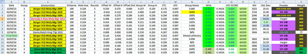

What is perfect for sorting, is an Excel Worksheet. In nearly every instance I sort the day's data by MOA and/or ATC (the same as mean radius) but I also sort by MV or SD or whatever parameter I happen to be testing. This set of numbers will reveal which combination shot best, but it is still hard (for me at least) to grasp the big picture from a matrix filled with a bunch of numbers.

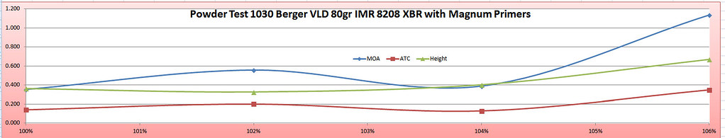

Once the data is in Excel, it is a snap to turn numbers into a chart or graph. When I do load development, I nearly always graph charge-weight vs. MOA and ATC and sometimes "Height", which is the vertical deviation. There is nothing quite like a graphic to make this kind of data easy to understand.
Here is a sample chart:
[url=https://flic.kr/p/JpwzP2]
You can see that a load of 100% of max published is best, but only by a hair. The load of 104% of max is nearly as good and, of course, is associated with higher MV, so it is most likely the preferred load in this instance.
I save the day's Excel Worksheet in a special file folder for that gun using the date and load-log serial number as a file name. That way it's easy to find later on. When I'm done, I copy the worksheet for that day and append the data to a master file containing every group ever fired from that gun.
Here is part of a master file sorted by ATC:
[url=https://flic.kr/p/KkWMpr]
That master file is like gold. To use an odd example, ask me which powder provides the second best vertical dispersion with an 80gr Berger VLD bullet. In a matter of seconds, I can say that the vertical is .097" using Vihtavuori N-140, load-log serial #1040 on 1/16/2016. I can also see that the results are not quite as good as the .067" vertical dispersion shot with H-4198 that same day. Furthermore, by opening file #1040 I can tell you the neck tension, primer type, case capacity, and whatever else you might like to know. Try that with a hand-written logbook.
You can make your Excel Worksheet as fancy as you like. For example, I color code things like powder type, bullet type, and I mark good performance so that important factors are easy to spot. Use your imagination and fine-tune the look of your spread sheet as you get used to tracking your results.
All this sounds like a lot of trouble, and to some extent it is more work than a simple hand-written log book. But the digital information is so much more meaningful. I believe if you're going to chase the kind of precision you need to feel confident in a match, or if your goal is just to have fun shooting the smallest possible group at your local range on Sunday, you must not only gather data but you also need a record system which will let you study that data and make sense of it. In truth, once you have done a couple of load logs using Word and made a few worksheets and charts in Excel, it is not as much trouble as you might think. It sure beats the heck out of wasting time weight-sorting primers.
