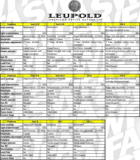

Is there much difference between the 3 generations? I see people prefer one over the others but don't really know why. Also, I know the Vari-XIII is the older but which is the newest? Thanks.
Steve
VX3 is newest. Coatings improved over the 3 gens. The VAri-x was first and the VX2 is now same as old Vari-x 3 as far as coatings
