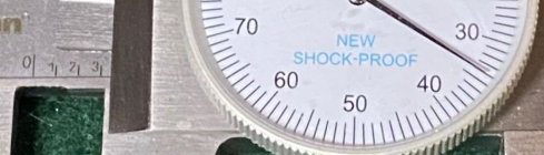

Dial Caliper?
The official method for reading anything with ticks is that you can do 0, 1, or half. The image above is 3.335. Can't be 3.334 because not a valid measure for a machine-era measuring system.
You might want to try that one again...
With a little help from the photo software:
Note the zero at the far left of the picture. Then count 1,2,3 which are preceded by a decimal as in 0.100, 0.200 and 0.300 according to this picture cropped from the original. So we now have 0.33 + 0.004 or 0.334 since according to the face of the dial each demarcation or 'tick' is 0.001 on this dial caliper.
There is nothing even close to 3 inches in this picture of the measurement.
Parallax is a PITA for dials, so learn that well to not fool yourself. Know what angle you are looking at, even as the dial moves across the face
When you get really, really, realllllly experienced at it, you can start trying for subsidiary fractions, but not everyone gets
lol that's what I was tinkin, .334 and that's it

The "3." Was a typo.
However, look at the angle of the dial teeth in the photo. That's not truly 0.334, more like 0.3343 because of the angle of view, a.k.a. parallax.
@papajoe222, when you close the jaws, make sure the needle is on zero.
Whatever trips your trigger.;)
Have a great day!
Yup, yup. Good calls all. Photos! No context I screwed up with the first significant digit, and indeed fell for what I said in parallax with shadows! Or maybe I am just too old, been too long since I actually could run a slide rule for real, used dial measuring equipment regularly, dammit :)
I believe the actual reading is 0.340.
The gray line on the dial is the needle's shadow from the light
The shadow is to the right of the numbers because the flash is to the left of the lens not surrounding it. Old school photographer from a time when cameras weren't "point and shoot". ;)
