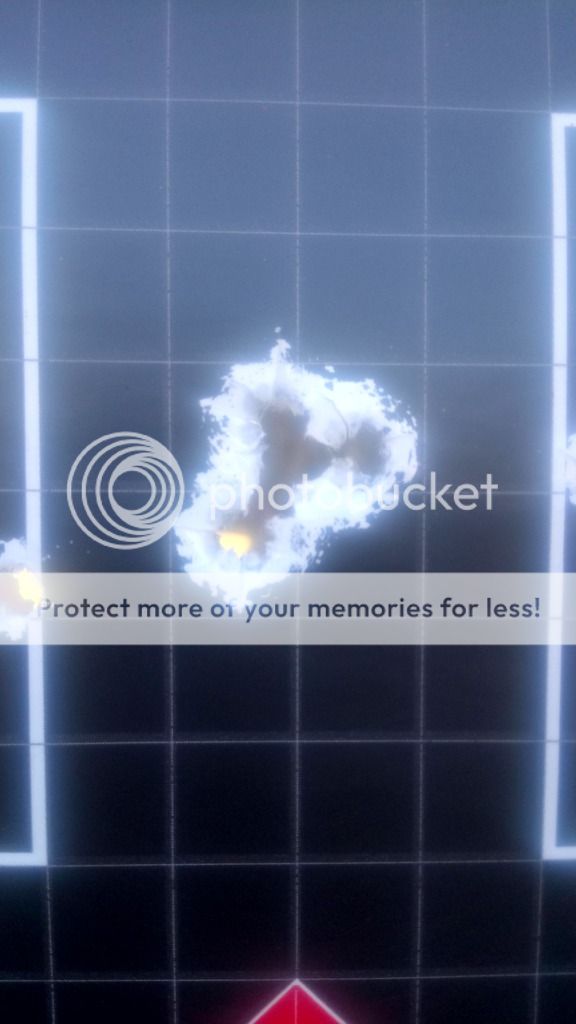

Sorry for the massively late reply. Thanks for all the advice.
RL33 is impossible to get here
We have an equivelant to Retumbo that is readily available.
I've tried 300, 250 and 225 grain pills, only the 250's seem to shoot
90 grains of AR2225, CCI magnum match primers, Ruag brass, and 250 grain sierras and I'm getting close
120m 5 shots 1 hole. Measures about 1/2" - for a factory Remington I'm happy with this and hopefully I can improve a little. It was at 130 yards (not 100)
