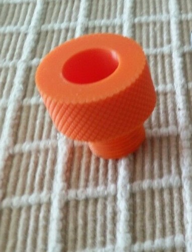

Next time you need some lock rings, give these Delrin ones a try. They lock up smoothly, don't 'pitch' the die when tightened and adjust like butter.
Good shootin'. -Al
Have a question in to the seller re: diameter and thickness. The Sinclair lock rings I have won't work very well with my CoAx without some modifications............
My Forsters are about 1.3625 dia and .315 thick.
The Sinclairs ae about 1.405 dia and .315 thick.
That difference makes all the difference. Hate to have to skim off some of the knurling/checkering.............
So seller just responded and said that they work with single stage presses. Maybe Al can tell us the dimensions.
They come in Green and Orange, Red and Blue coming out next...... also have bullet pullers in Orange, Green, Blue and REd on Ebay and they work great !!!
SIZE= .315" thick, 1.440" diameter
Maybe I missed the boat here, but what is the advantage of using these?
Paul
Now you can use this high quality US MADE plastic rings with adjusting screw compatible with your Lee, RCBS, Hornady and other US MADE reloading dies, no more guess work, these rings will lock your die without damage to threads, no more rust.... and most of all, it will not move from set position, when tightening screw, keep in mind not to over tighten, it is not necessary to over due it, the ring will lock ! ! !
