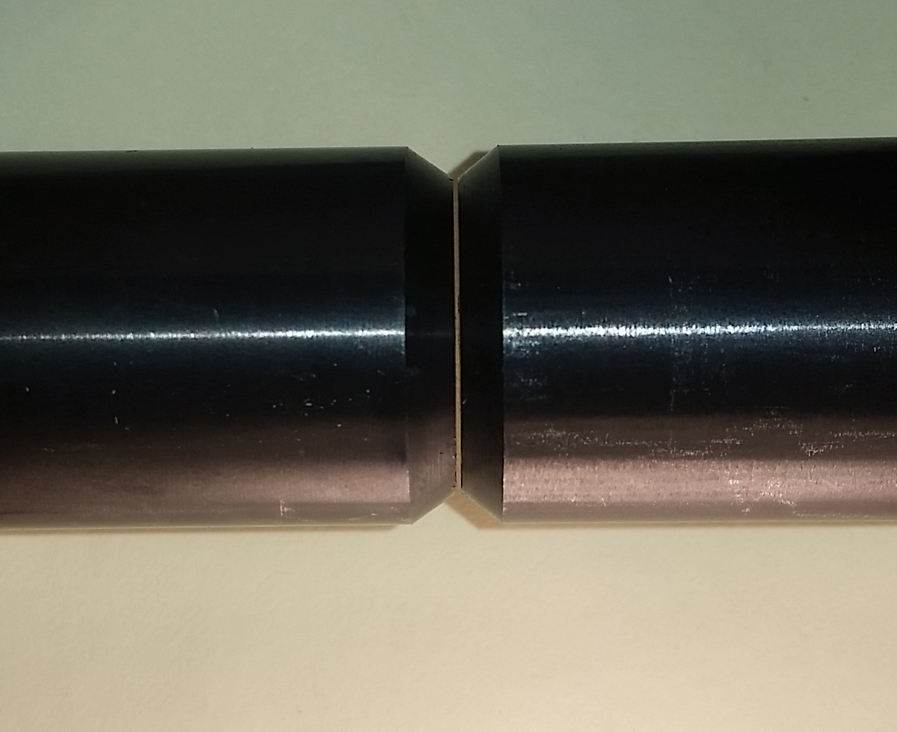

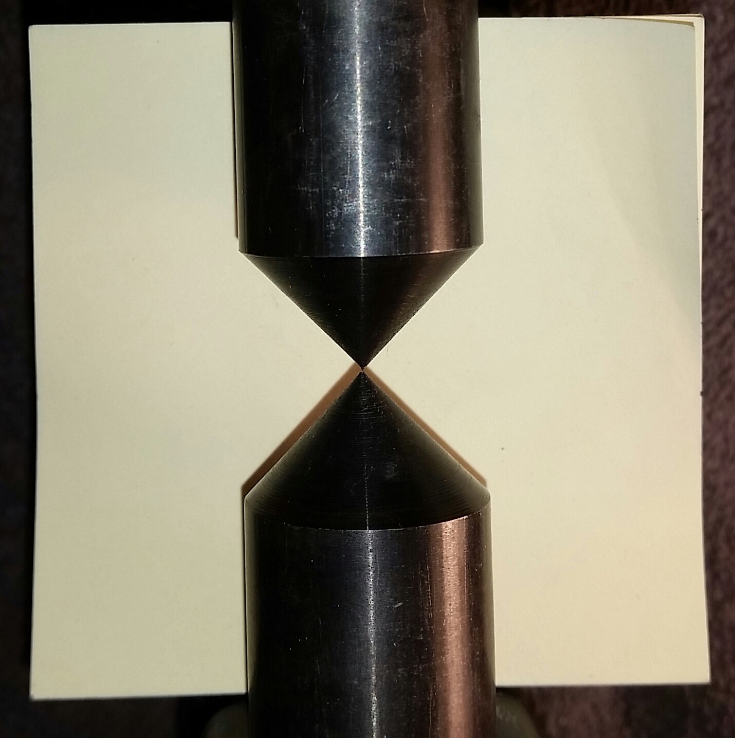

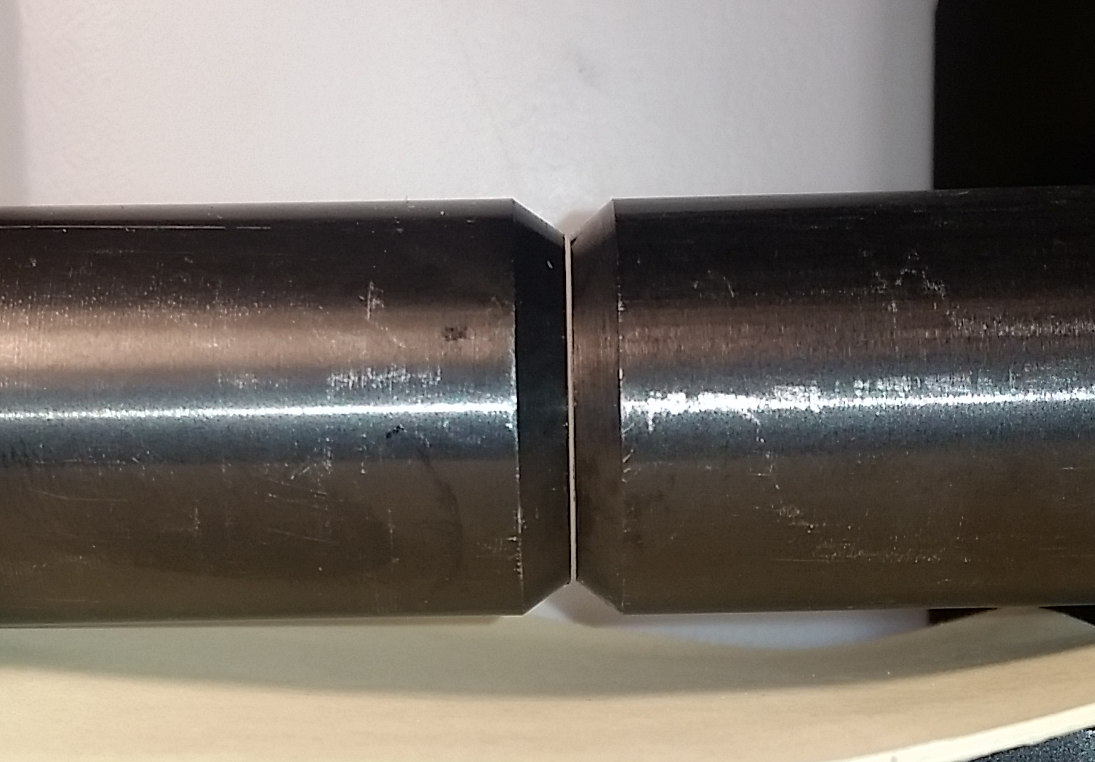

Thanks for the replies. I was doubting the accuracy of the points on the so-called precision ground bars as well. Cheap tools are usually just that... I was trying to think of a way to actually measure something so thanks Boyd for the link, it gave my pea brain an idea, so I flipped around the bars and started used feeler gauges to get some actual measurements and a visual. The caveat of cheap tools still applies, but at least I can actually measure something now.
After thinly bedding and very lightly lapping the mount, I think I have a result that is more than close enough.
Going straight up and down, there is only ~.002 difference. A .010 gauge slips thru all the way, and a .011 gauge fits in from the bottom to about 1/3 the way straight up. A .012 gauge will just barely catch at the bottom edge.
From side to side it is even less than that; a .010 slips all the way thru and the .011 just catches at the left edge.
Seems to me anyway, that this is a viable way to actually measure "close enough"?

To try and verify if the measurements I got were meaningful, I turned the bars in the rings about 90 degrees and re-measured:
.010 guage: all the way thru both up/down and side-to-side
.011 gauge: 1/4 the way in from top down, 1/3 the way in from bottom up
1/4 way in from either side
.012 gauge: just catches top down, 1/8 the way in bottom up
just catches both sides
So this result is ~.002 again, which I am very comfortable with.
I use the .010 gauge to set the bars initially and tighten the caps to spec before taking measurements.
