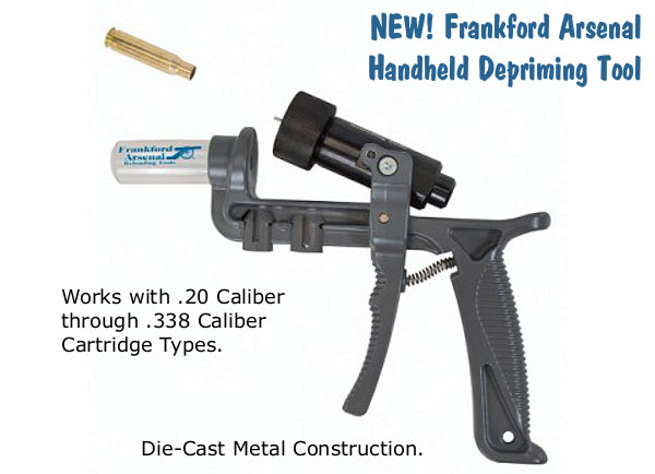

Another option. We haven't tried it, but buyer reviews have been quite positive:
LINK: https://www.frankfordarsenal.com/hand-deprimer/909283.html#start=1
Product Description:
This new hand-tool from Frankford Arsenal will deprime (and capture primers) conveniently. You can deprime your cases while watching TV or relaxing in your favorite chair.
deprime deprimer, de-prime decap decapper primer Frankford Redding Lee priming die
With a universal, cylinder-style cartridge-holder, the tool can deprime a wide variety of cartridge types from .20 caliber up to .338 caliber. Spent primers are captured in a removable spent primer catch tube. With die-cast metal construction, this tool should last through many thousands of depriming cycles. MSRP is $54.99.
NOTE: A couple guys posted that the capture tube can work loose. This was fixed however with a layer of tape around the top, increasing the friction hold. Or, you can dispense with this by pointing the unit down and "shooting" the spent primers directly into a waste bin.

I second the Frankford Arsenal tool. I use mine for Black Powder Cartridge Cases. Works great. Now using it on small primers in Lapua brass I would test it on a single piece before I committed to doing them all.
