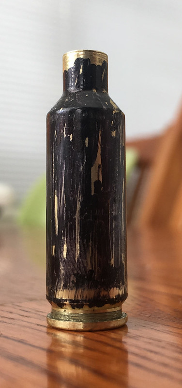

Neck is .272”, so no turn. Also I confirmed the base is the only place touching via sharpied cases, both formed Dasher and new BR.

When you say "the base", do you mean at or near the .200" line or some where else?
Would like a better description or picture of where your getting brass shaving/swiping off the case(s).
Brass swiping on the base of the case-head, the length to the shoulder is culprit = more set back is needed.
Brass swiping of the webbing/expansion line, the diameter is culprit = a smaller diameter die will be needed.
Donovan
I mean the .200" line Donovan. This is where I am measuring and also where I'm shaving brass. I suppose I can order a tight die and see how it goes...
