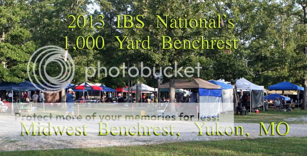

I just joined the forum to congratulate Henry and share some of the photos I took at Nationals.
Not certain of photo size limits, but I'll start with a pic of the Champ.
Hat's off to you Henry!
Our little community for a few hot days!
