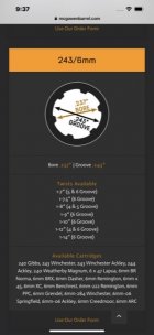

Are you measuring outer to outer then subtracting 264?

I figure that bullets get squeezed down a bit to fit the bore diameter so the size of the bullet holes on paper are a bit smaller than the actual bullet diameter. For me, I just use bore diameter - easier to remember (.237, .256, .300)
For 6mm, I was told that it's easier to use a 22 caliber scribed hole on the measuring tool cause it fits right over a 6mm bullet hole better than a 6mm scribed hole. Seems that a 6mm bullet hole on paper is closer to .22x in actual diameter.
When I measure the bullet holes on paper, 6mm measures more like .227 and .308 measures more like .290 - at least that's what I generally get (rough measuring):
I've seen other posts on AS where they subtracted a smaller number than the diameter of the bullet. Here is an example where shooter is subtracting .290 for a .308 bullet.
Nothing wrong with subtracting the bullet diameter - that definitely is the easiest number to remember (easier than the funky numbers I posted above).
ymmv
View attachment 1344713 View attachment 1344714
ymmv
