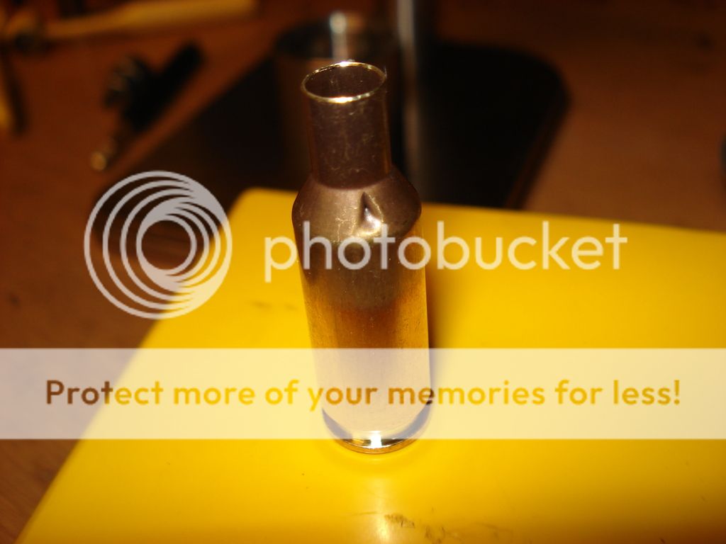

I just found this,, it is a brand new never fired piece of 6br Lapua brass that I just got done expanding the neck a little and chamfered and debured,, then I saw the imperfection.
That's a common thing in 6 BR Lapua. That one is a little more then most. Usually it's just a little mark. When fireforming to Dasher they usually blow through right there. I just pitch them. I don't want the burn and grit in my chamber. Matt
That is my thinking too,, I'm gonna toss it, don't want it to score my chamber if it leaks.
