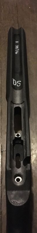

I bought a CZ455 Trainer and built a BR stock for it. I pillared and bedded it. It's a little tricky because you have to grind away half the front pillar because of the magazine clip assembly. It shoots great on some days and just good on other days. It likes Fed Ultra Match ammo. I made a large target, zeroed at 50 yds and recorded POI out to 200 yds. went home and created a MOA Chart out to 200 yds at 5 yd interviles. So I figure I got this, right. Wrong, the next time I went out it was cooler and less humid. it shot at least 1 MOA different when you got out to 150 yards plus. Anyway Temperature and Humidity have a lot to do with 22 rimfire shooting, IT CHANGES EVERYTHING. Attached is a pic of the stock I made and it made a big difference on accuracy.

Some sort of trigger job is what you need first, then bedding, check the chamber and crown for burrs, also make sure the bolt guide is not preventing the barrel from seating firmly against the action, check torque on barrel grub screws also

As to trigger, I found replacing the spring for less than $1.00 with an ACE Hardware old #144 got me consistently to 10 oz. pull. There is some creep, which I learned to like since it got me pretty close to a two stage trigger. As stated above, the pillar near the magazine needs to be cut away.
