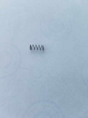

I was working on my 457 trigger today. I did some polishing and cut a couple coils off of the factory trigger spring. It feels pretty good now but I haven't put the pull gauge on it yet. Smoothing out the contact surfaces helped a lot. They looked like they had been finished with a rasp. Anyway, I noticed that the OD dimensions on the trigger springs that have been mentioned here are somewhere in the .140's. I measured mine with two different calipers and came up with .110 on both calipers. I bought this rifle new so I'm not sure why the difference. I think a slightly bigger diameter spring would fit but I don't know how much bigger. Has anyone else seen this or have any thoughts ?
I bought this one, works great. Only problem is it went up .50. LOL
I used the same spring and my trigger pull dropped from about 3# to 15 ozs. It still has a touch of creep but I am not going to try and smooth the surfaces, I would probably screw it up and end up with an unsafe trigger.
My buddy just got a new 457 AT-one. I mounted a scope on it for him to try and we headed to the range to put a few rounds through it. I had adjusted the trigger pull weight down about as far as it could go but it still felt like it was well north of 3 lbs. I took it apart and got the trigger spring out and took some measurements. OD was .147 and the wire gauge was .027 ! It's like a truck overload spring! I couldn't compress it at all between two fingers. It's nothing even close to what I found in my 457. I ordered a package of the CO4-12-16 from fastenal since that is something close to what I found in my trigger which I was able to get to 11 ozs. I'll see how it goes when I get the springs.
The springs I ordered from fastenal were going to take another 6 weeks to ship so I canceled. Ordered Raymond spring C01200120500M from grainger which got my buddy's 457 to 15 oz. I had to get 10 but several people where I shoot have 457's so they'll get used. Came to $2.30 ea. shipped.
I got mine off ebay for 7.99.....with free shipping....I have two of them in two 457's both went to 12 oz or a little less easily, lightest pulls I have been able to get and I have tried several other brand springs and these are the best, they also are custom made.
