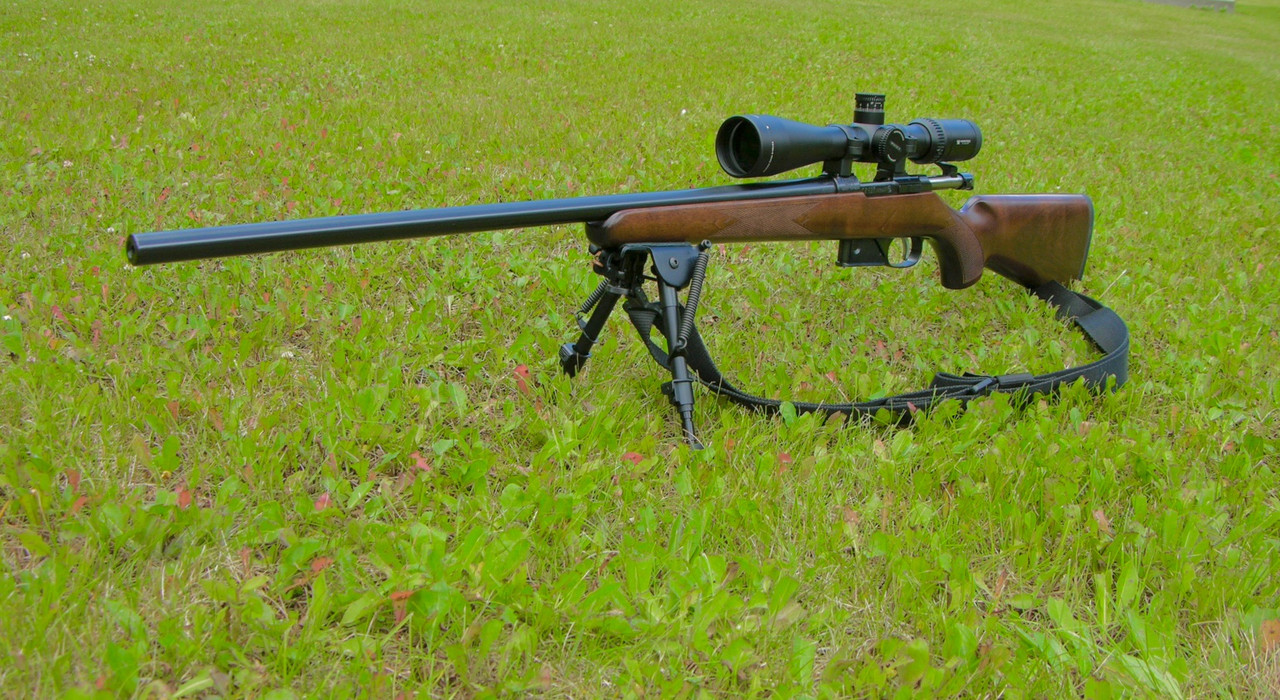

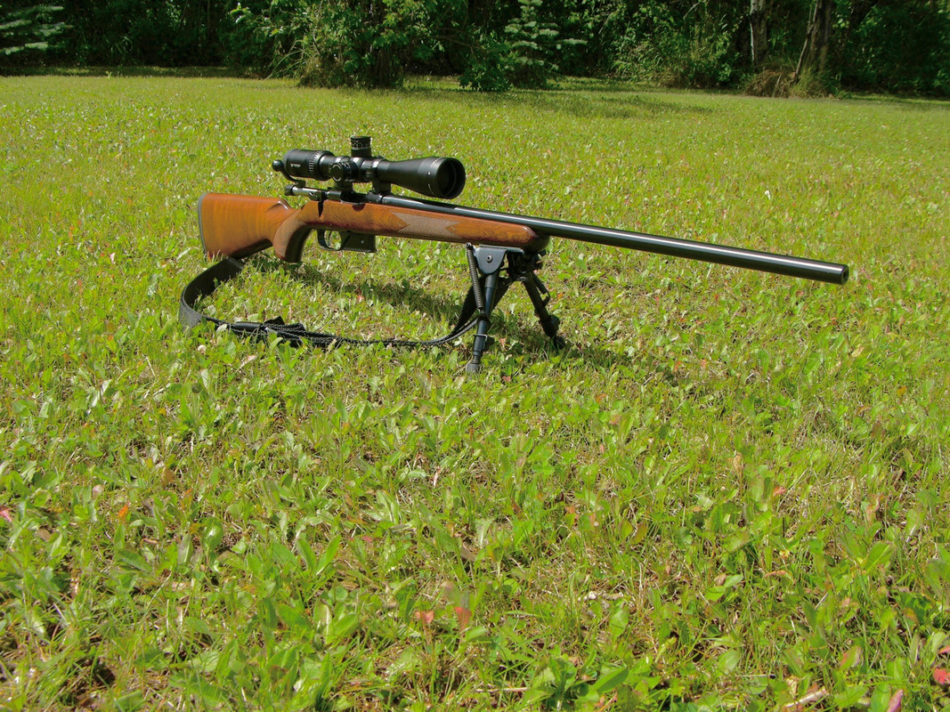

So here's my new CZ-527 Varmint in .223rem with a 1:9" heavy 25" barrel. I topped it off with a Vortex Viper HS 4-16x44 and a Harris bipod. This will be my new 300 yard gopher, rabbit, and coyote gun.

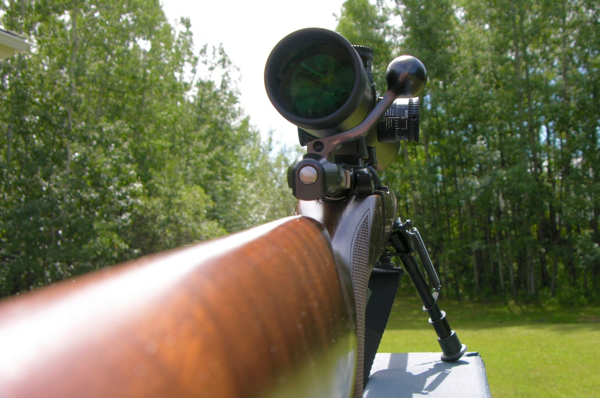

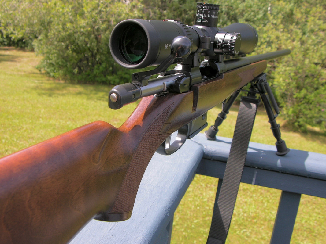

CZ also has a somewhat "proprietary" mount for rings. Finding a set proved more difficult than I expected. Also, earlier versions of this "mini-mauser" bolt handle proved tricky when mounting a scope. You had to have very high rings so the bolt knob would not conflict with your scope. Thankfully, CZ changed the bolt handle design and this problem is not as tricky now.
But as you can see, I seemed to have gotten the "geometry" just about perfect.
BTW, those are Leupold rings. And I also got the scope nice and low over the barrel.
