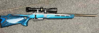

Well after a huge investment of $1.00 for a new Dremel cutting bit at a barn sale the rifle is complete.
I made a Dremel tool holder out of a slab of aluminum I had, mounted it up and started cutting. It was trial and error but I got it done. Shot it yesterday, cleaning every 3 shots. This was PPU factory ammo. Can't wait to start the search for the powder/bullet combo for the upcoming trip to Montana.
