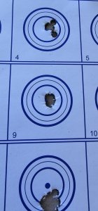

I have the @One and consistently hold better then 1/2 moa at 50yds using SK Red and Yellow box ammo. I have tried a couple lots of Eley match and tenex and for whatever reason it just does not like the lots of Eley I have tried. I’ve shot many 200’s in BR sporter class with it though I’m still looking for one that shoots better groups.
I have done a spring change on the stock trigger and am currently at 13oz on the @1 and 9oz on my MTR.
Like @Dgd6mm mentioned I agree totally with his comment on cleaning the barrel is a must. If I’m shooting for scores/groups both my guns open up in the 75-100 shots so I’ll run a patch down the barrel with cleaner and then a dry patch afterwards and I’m good to go for another round of shooting.
I always clean my guns after I shoot it, Period.
