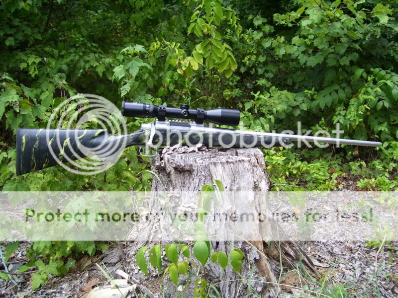

Rem 700 rebarrel in 6BR, #3 Brux @ 20", HS precision, Shelin Trigger with Lupy 3.5-10x40CDS. This rifle is VERY handy & shoots better than it should for an 8# rifle. I built this rifle on a "budget" & didn't true the action & it still shoots under .5 inch groups with an occasional group in the .2's. Way less than $1K in the rifle itself.

I have a Wyatts "BR Box" in the grey rifle pictured. It has been a royal pain in the ass. However, after a LOT of trial & error tinkering it feeds good but only holds 2 down.
I have another BR repeater using the "Mike Bryant conversion" with Rem bottom metal & it feed GREAT ofter finding the correct placement of spring (the main presseure needs to be correct for 100% reliable feeding). It feed 4 out of the belly like hungry hippo's. The only week link then is the Rem extractor (it bloops the short case out & sometimes doesn't clear the breach).
I'd have no quams about doing another BR repeater. The BR can be made to feed with a little effort. I think Alf on here (surprised he hasn't chimed in he's got a bunch of VERY cool sporters) runs some dashers with no modifications. Search my post here & 24hrcampfire. I've posted more detailed description of the Wyatts box if interested.
