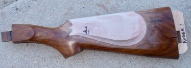

I told Keith I really want a cheek piece butt stock (love the look on an 1885...). Treebone Carving does have a pattern No 1 with a check piece, but Keith wanted to do it a little different. He took a old regular No 1 butt stock and added in a cheek piece to it (using a wood block and bondo) for Treebone Carving to use as a pattern. The fore end was ordered with inlet for action but the rest a square block. I talked to George at Treebone and sent him a check for a nice piece of fiddleback walnut and a steel butt plate. George Petersen and Treebone Carving are the best!!!

Butt stock photos, notice the steel butt plate....
