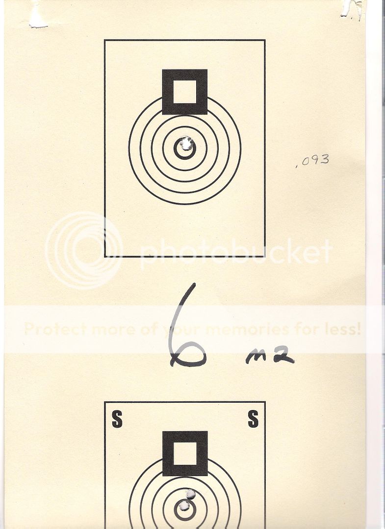

I just grab some case and go, if I find one that bolts down hard, or has a click in it at extraction I throw it out. The idea is to make all of your cases identical. when I neck cut cases I do them by the 100 lot. I then grab 25 or 50 cases and fire form them, and shoot them until they wear out. If I have an unexplainable shot I will turn that case upside down and mark it, but other than that I don't mark any cases. I basically want all of my cases to shoot the same, or I get ride of them. Here is a target I shot in the first club match of the year. It is 5 shoots at 100 yards. I have no idea where these 5 cases are in my box, because all of the 25 are capable of producing this.
Funny part about these cases, I bought a used barrel off of a guy. He was upset because the PPC case was so labor intensive. These 25 cases he neck turned, and was unfired. I re-turned the necks, and straightened everything out, and this is what I got. I had another 0 group going that same day, but I got distracted, and shot a mid .1 group.
