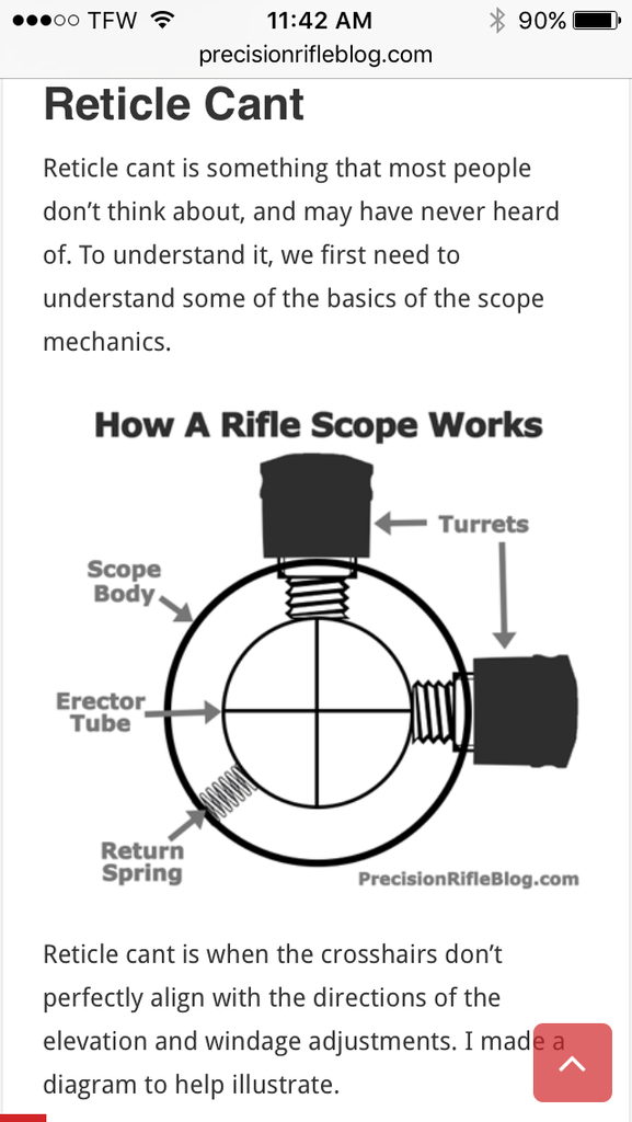

Even in quality scopes the reticle can be off center 0.5deg-3.0deg (extreme case).
Leveling the scope using the reticle or crosshairs as the primary reference point with a plumb bob may result in inadvertent scope cant.
Using a level on top of the turret may also result in issues as you can't be positive that the turret is level in reference to the rest of the system.
If you confirm that the turret is level you can use it as a reference point. Then true the crosshairs to a plumb bob at a distance like mentioned.

After you level the rifle if you true the crosshairs to a plumb bob it still may not account for reticle cant.
By tracking the crosshair all the way up you can note any deviation or reticle cant.
I'm going to try your method with a flashlight to project the reticle. A light just turned on
Thank you. Correct it allows you to see any cant as you dial your turret. I would rather have it slightly canted and have it track true than to have it straight and track crooked.

Attached is some food for thought. I think most of us are on the same page, just getting there different ways.
http://precisionrifleblog.com/2014/09/19/tactical-scopes-field-test-results-summary/
