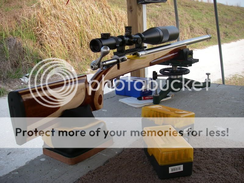

1. This is my most accurate rifle. Dual port Savage 6 Dasher. Nightforce and you can see the rest. Really does shoot .1's to .4's. Next is a 40X with Broughton in 22-250AI that shoots .3's and often better. After that a model 70 270 at .6's and a Remington 257 Roberts also .6's.
Only this rifle uses this rest. I have others, nice but simple for rounded forends on other rifles.
