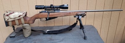

I built 4 rifles in Sept. I have no place to shoot in Seattle. In Oct I drove 900 miles to go hunting. I sighted in a 25 Krag Ackley with unformed cases and full pressure loads. I could hit the 1/2" bullseye at 200y. All the shoulders split during sight in. No chamber damage seen with automotive borescope in the small town.... When I shot a deer the shoulder did not split, it was 4 degrees and the CFE223 is a little temp sensitive. The other rifles were 7mmSTW, 250 Sav, and 6.5-06. They did not have case forming problems. The only Ackley I like is 280AI, because I can get Nosler brass.
